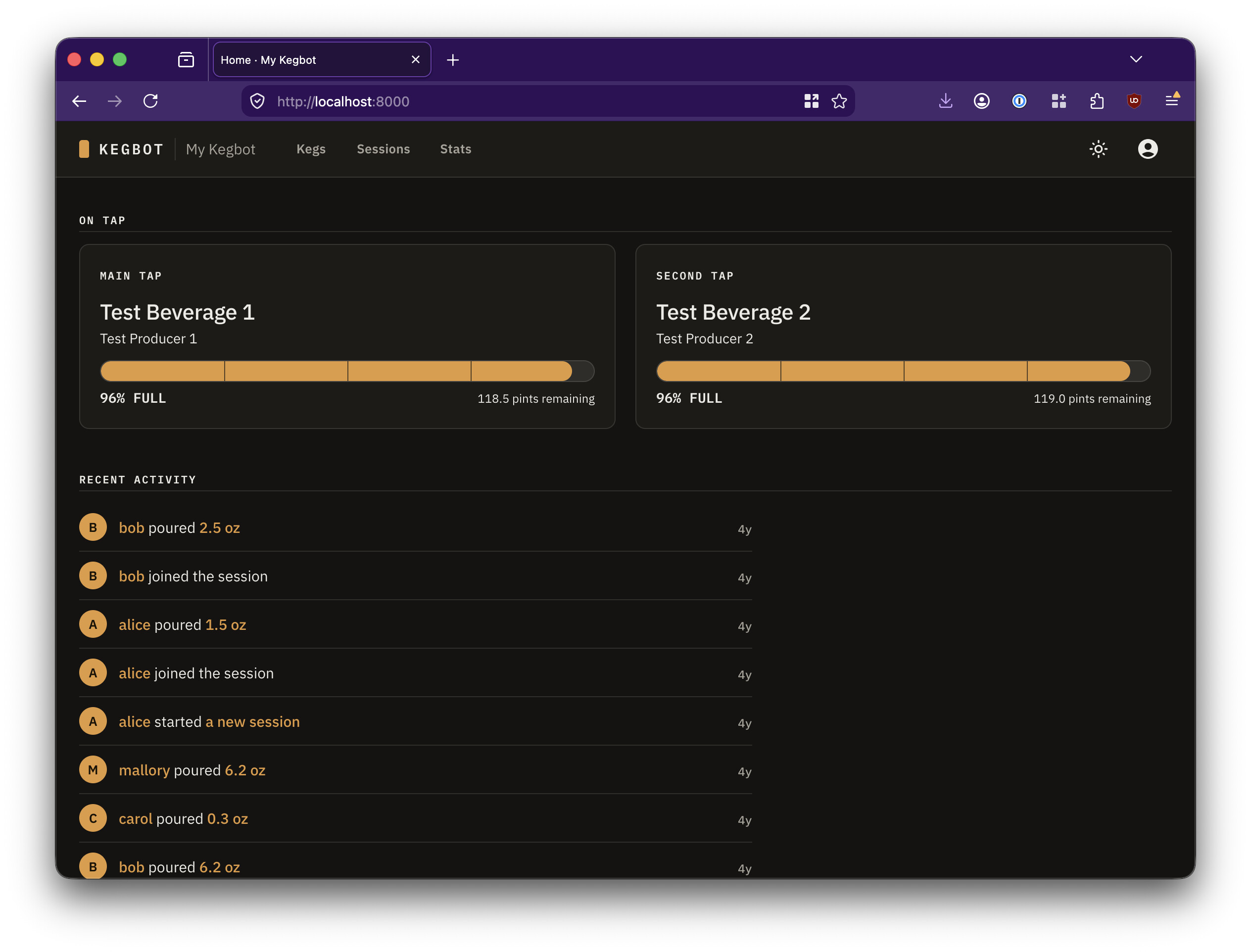

Update: Backend changes, including a new API and rewritten ReactJS dashboard, are coming along nicely as well.
The current focus remains on modernizing the stack, so the overall layout, information architecture, etc, aren’t dramatically different. New coat of paint + major under-the-hood overhauls.
You can follow along here if you wish.
