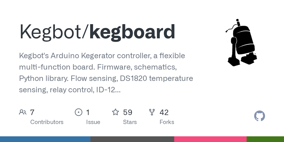

somebody can tell me where I download the keg board source code
Kegboard source code is available here, specifically under the arduino/kegboard folder:
