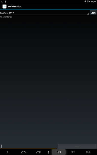

When I connect to the tablet using a serial monitor app I get “no serial device”

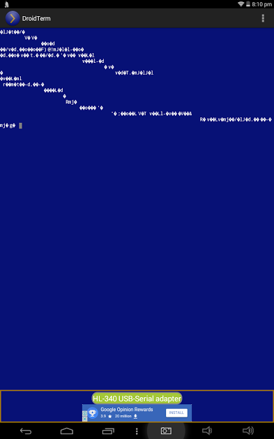

I tried the app “DroidTerm” as it specifically mentioned support for CH340
USB Virtual Serial Port
Connect
When blowing through the flow meter again I get a stream of characters.
Kegbot still does not see the flow meter
