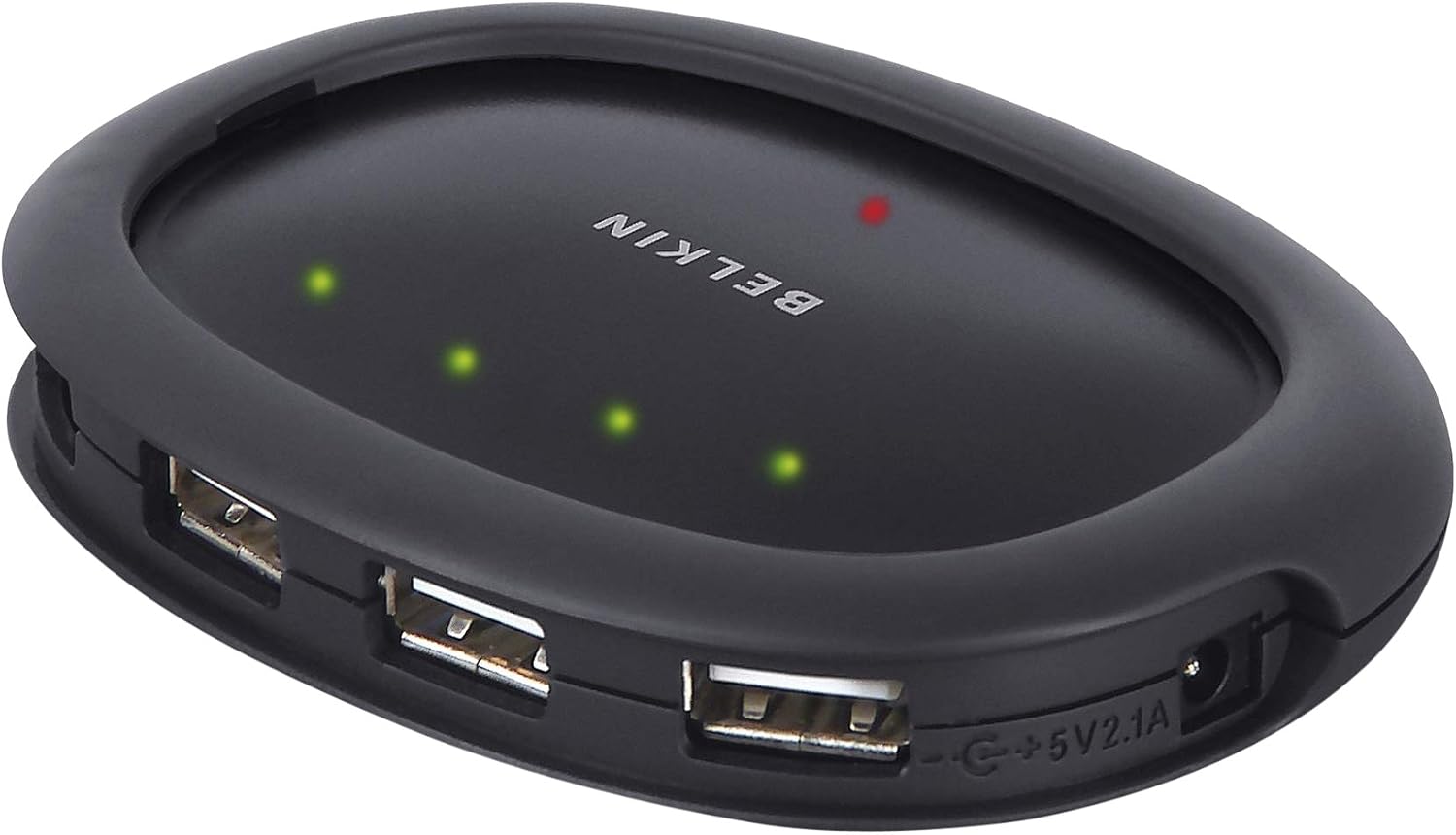

I ordered the hub you use, so hopefully that fixes it all. thanks

Hub works on the nexus 7. 2nd tap will not save my pours.
