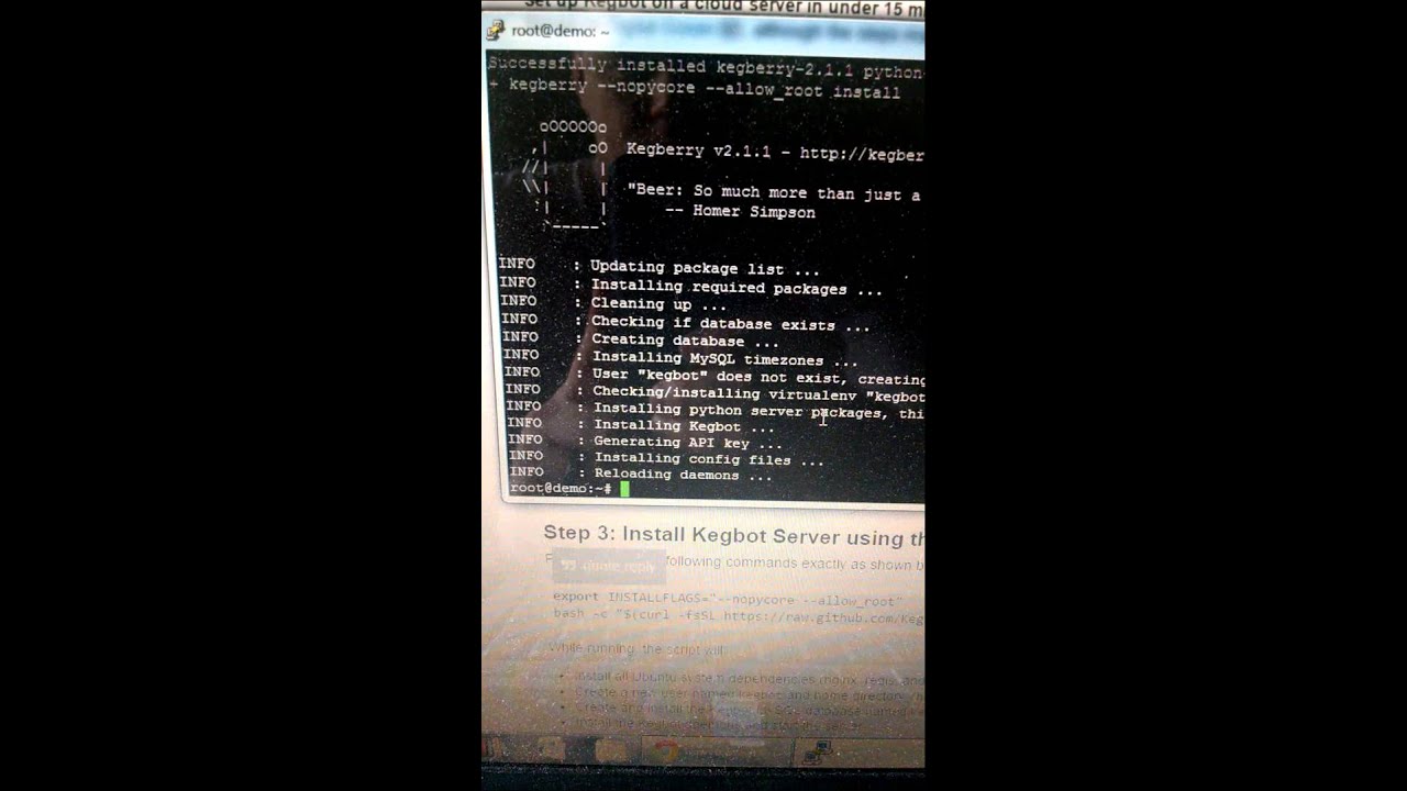

I made a video of how to do the install via putty for windows. Hopefully this helps some of you. You can view it on YouTube here:

What version of Ubuntu is your droplet? Make sure it is 14.04 x 64
Thanks a lot Joshua. Now I have to start with the set up.
Once I chance the ubunto your script run smoothly
Thanks a lot
