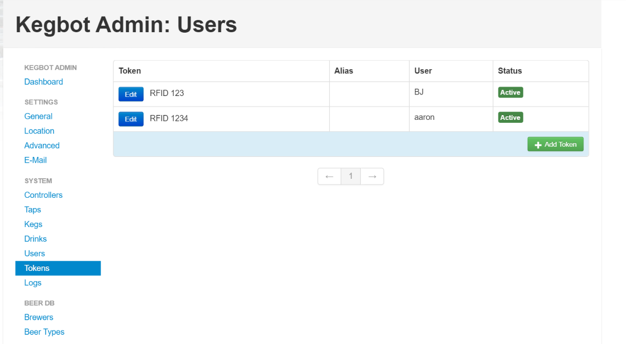

Currently I have a DIY board that can talk to the card reader ok, and can run python scripts to GET/POST to the RESTful server. So what I am trying to understand is exactly what is the format of the GET/POST.
I have seen the comments about “adding a token manually, or through the REST api”, but my attempts to do this via curl > curl http://localhost/api/auth-tokens/rfid.1234/?api_key=abcd
respond with “Not an API endpoint”. I have manually added a token, but not sure if I did it correctly
So I tried a few curl attempts, all the same response.
