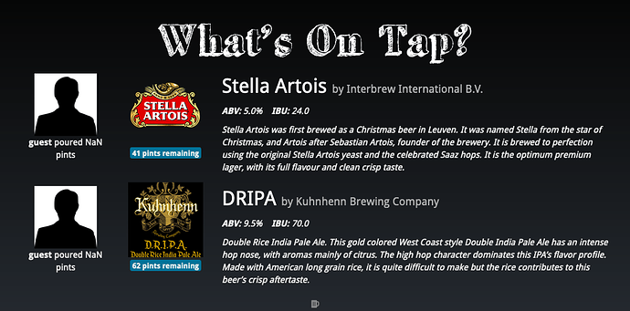

I finally connected the flow meters last night. I am getting flows on the Arduino and kegbot is recording them. Now I get a spawn error every time I try to launch the node server.

Just figured it out. I changed the privacy settings from Public to Members Only. Looks like that won’t work with the node server… Changed it back to Public and now I am able to start node up again.
Hmm, alright. Yeah the Node Server thing is a VERY manual process right now. I’ve been working throughout the day to get a one-line script with the RFID and latest stuff included, which actually has gone well. I’m just now starting on the Node Server stuff but will probably have to be tomorrow or next week before I get everything fully integrated.
One of those things that works perfectly on my PROD setup, but I can’t remember exactly how I set everything up in code since I was lax about actually checking into source control!
Stay tuned for updates and thanks for your help!
