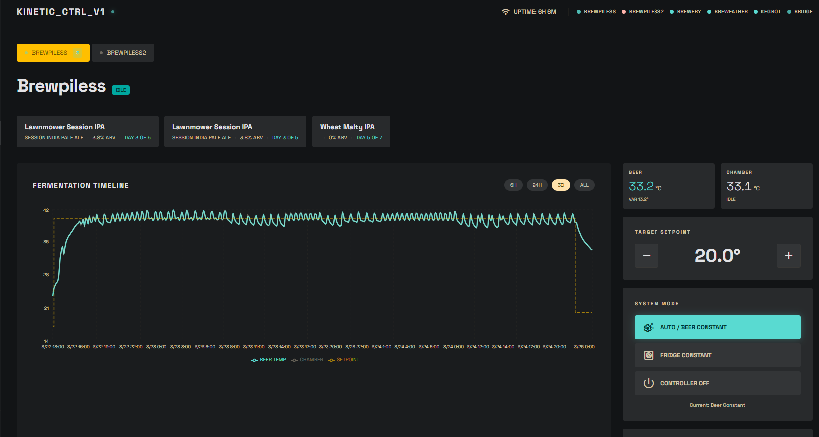

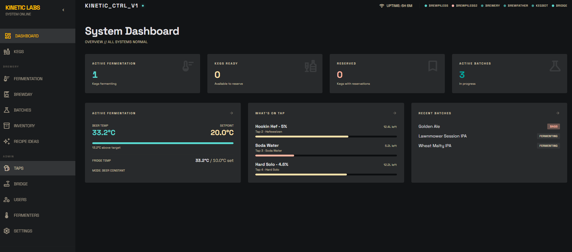

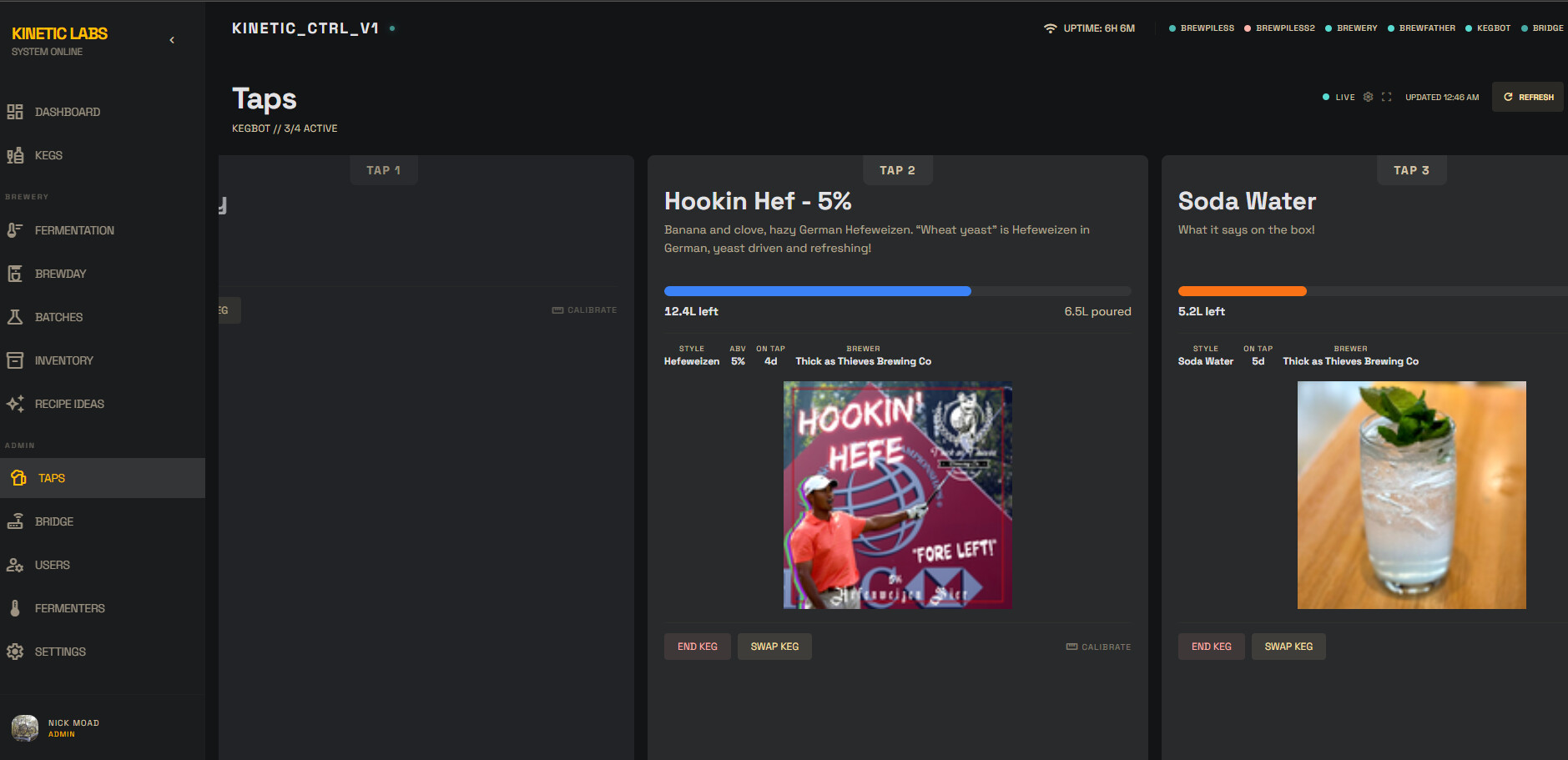

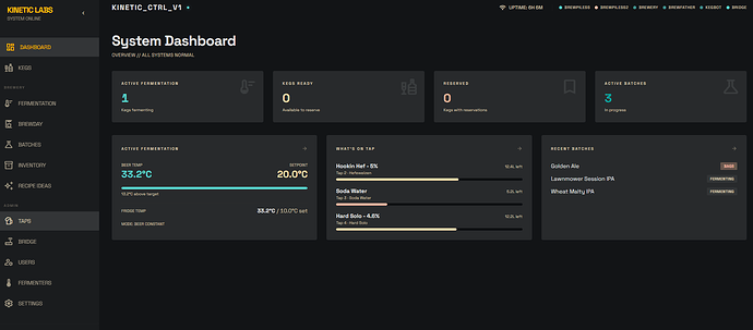

I’ve been spending a bit of time with Claude code and was wondering what I could do with kegbot. One thing I’ve battled with a little is finding the right tablet. So I got Claude to write me a bridge that runs on a raspberry pi. It takes the ticks from the arduino and presents a web socket so you can get live pours. My web server takes that and essentially does what the android app does. The pour counter isnt as smooth as usb but it’s very much good enough. It also let me work around one issue with calibration in that now a calibration pour will send to the server with the new calibrated value. No more manually updating pour volumes!
