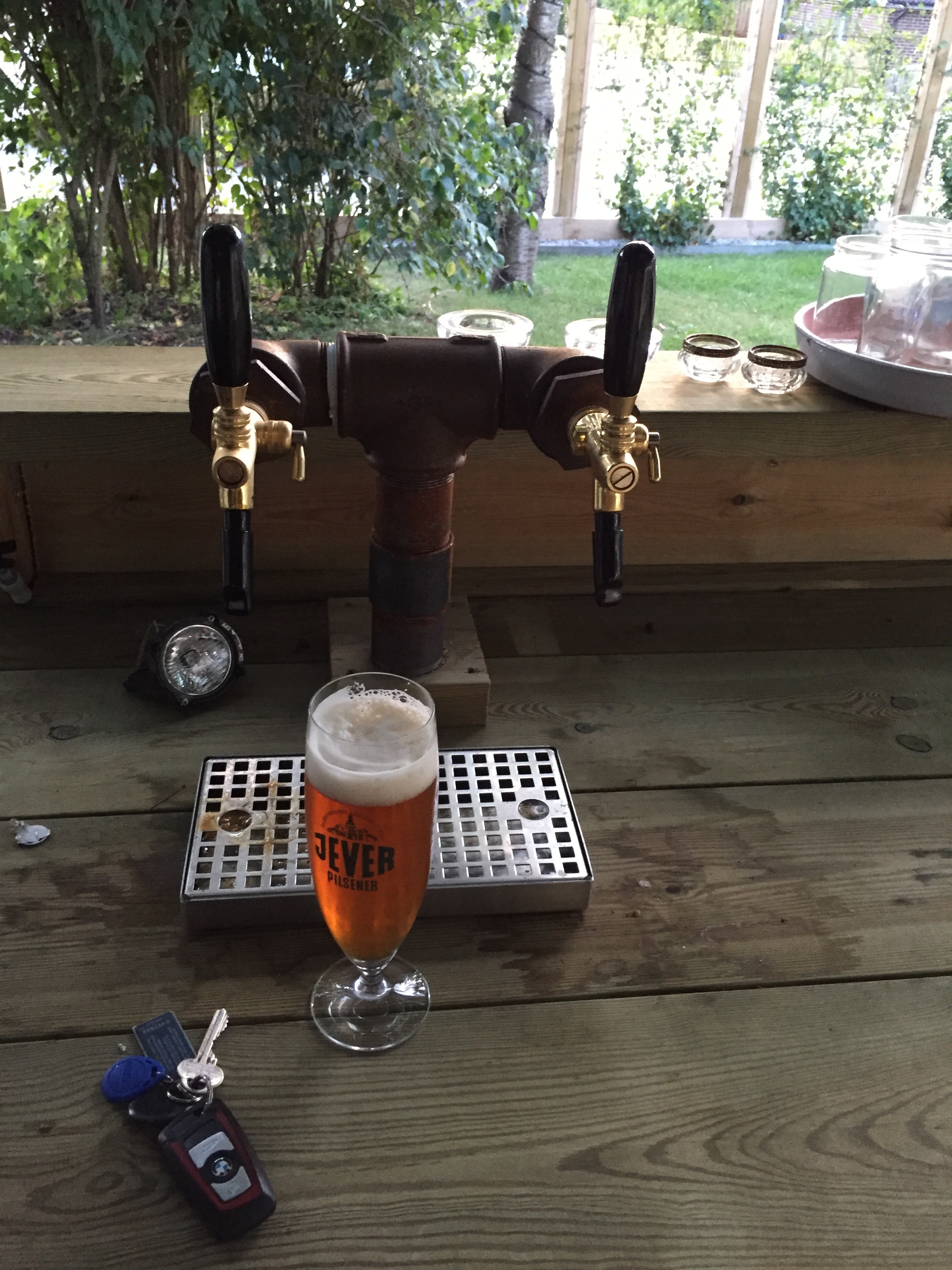

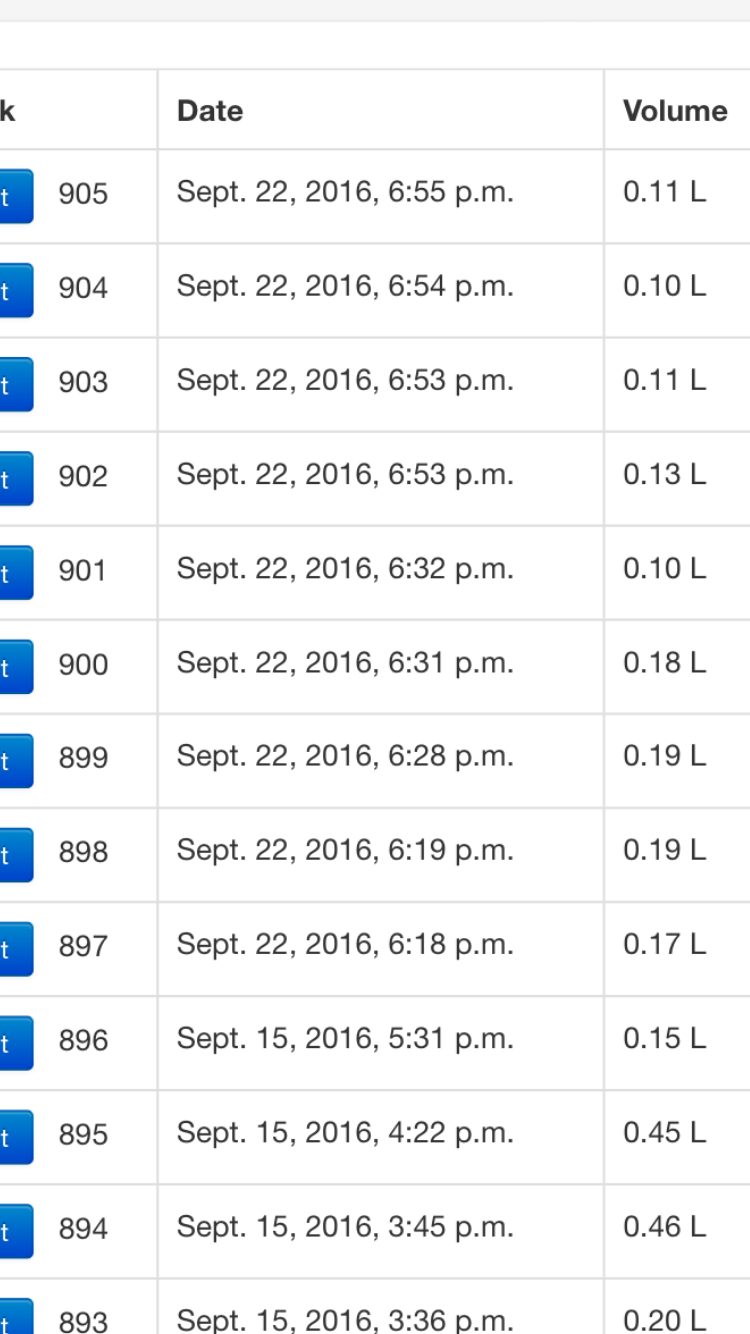

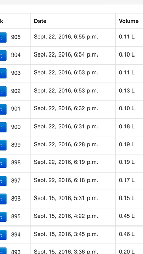

I’ve built a kegerator and this is version 2. Something weird has happen with the solonoids, they close after 10-20 cl been poured.
Regulator is on 2 bars
Any ideas?

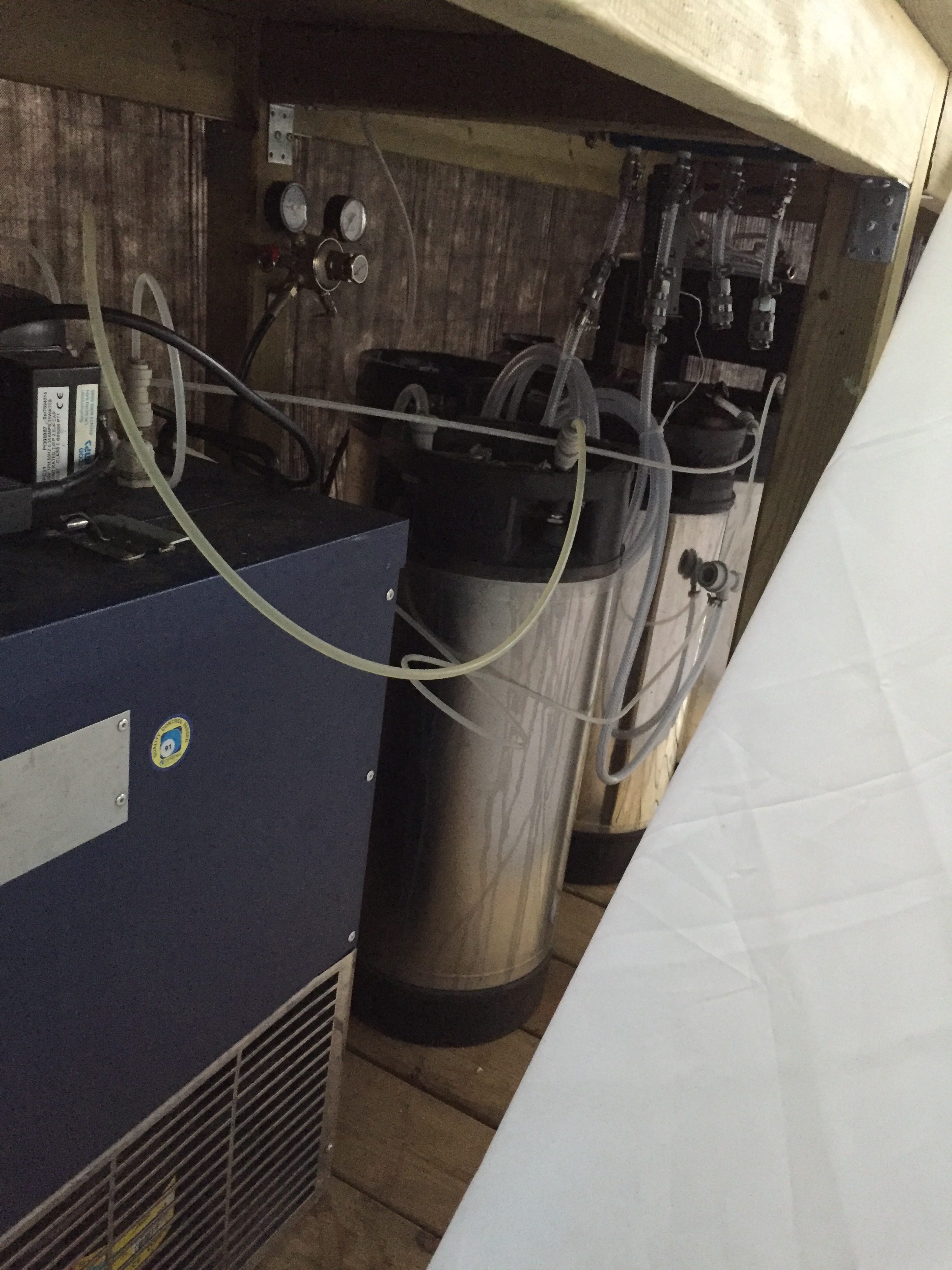

Got 6 kegs and two taps. threw away my fridge and bought a beer cooler with 3 in and 3 out lines.

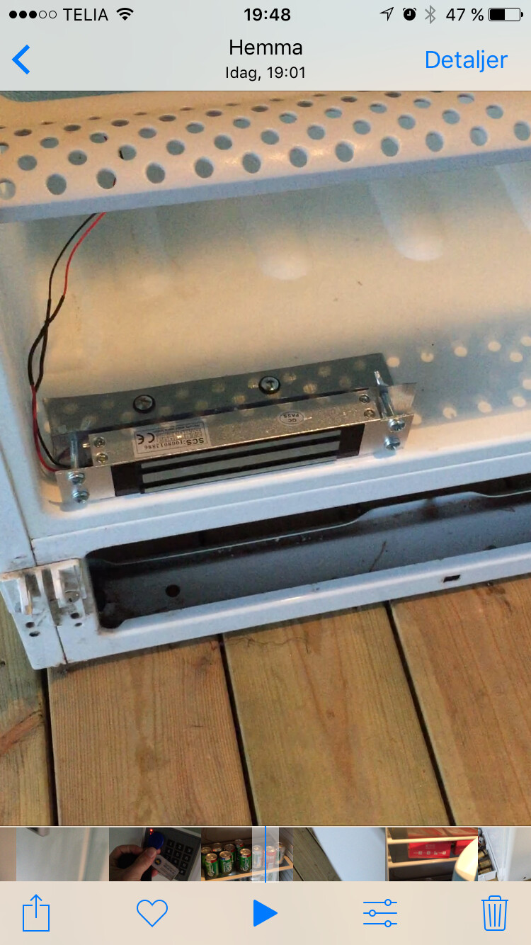

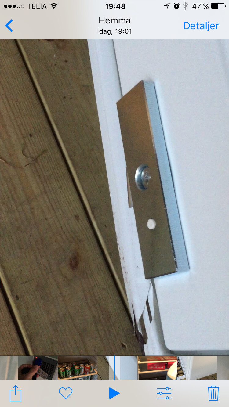

Bought a magnetic lock for my fridge, containing beer cans and wine, keeping the neighbors fingers away..

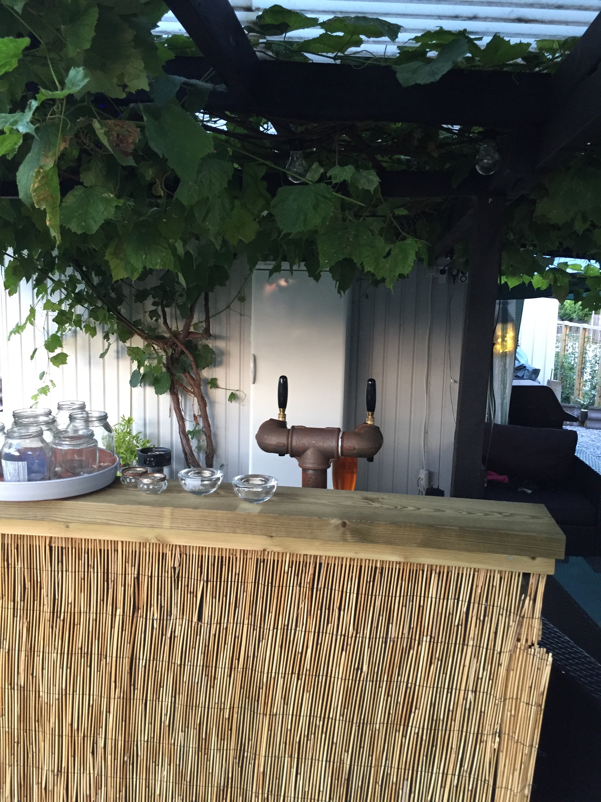

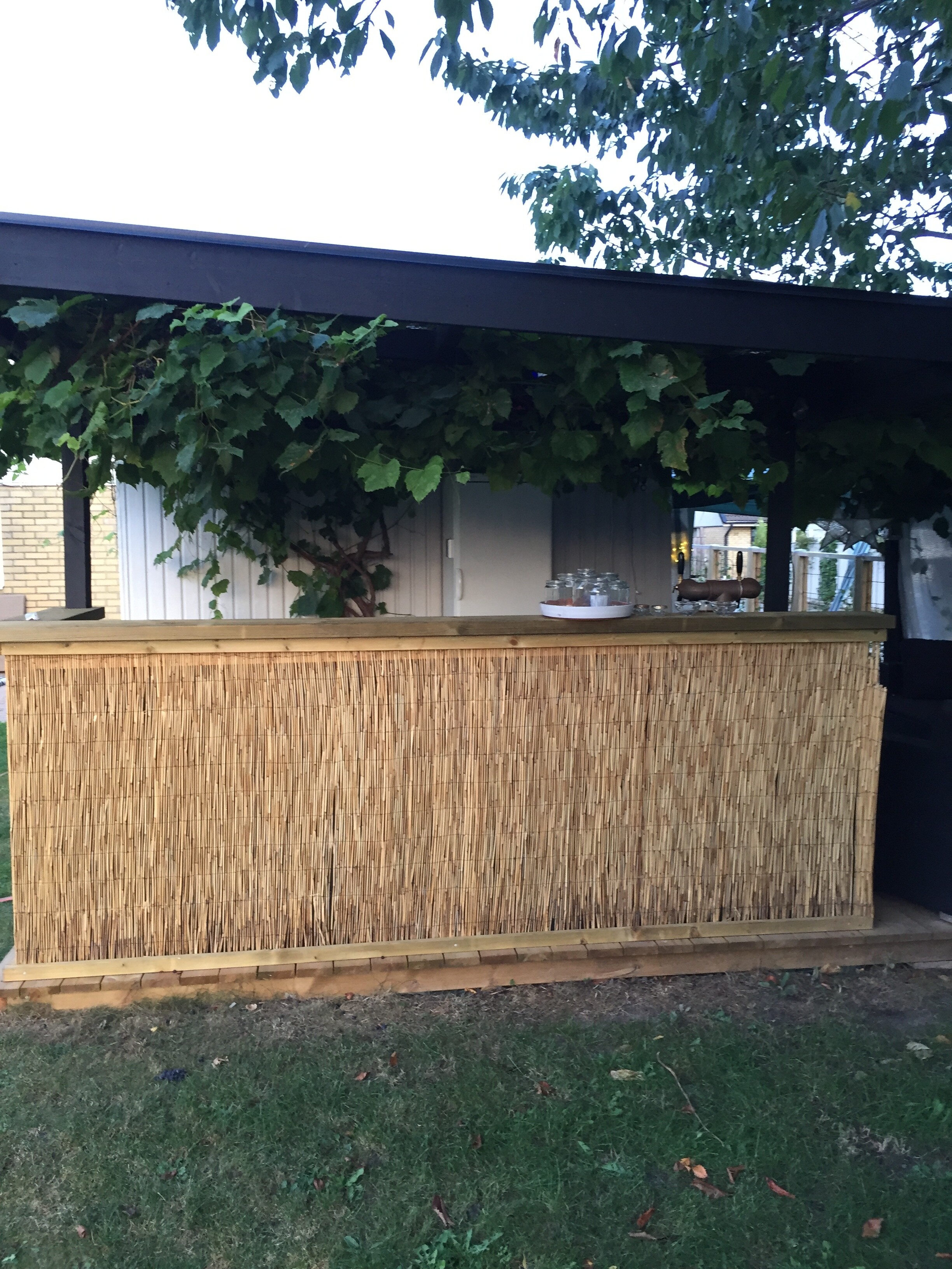

Adding some pictures on my setup

Bare et kompliment til nabo landet, Kjempe snygt oppsett!! ( Just giving a compliment to my swedish neightbor :slight_smile: )
Your setup looks great.
What kind of solenoids are you using?
How are they wired to the arduino?
Does the android app still think that it is pouring, and what is your timeout set to?

Is the relay staying on throughout the whole pour?
If the relay is staying on the whole pour you may need more pressure (2 bar should be enough according to the datasheet on that solenoid)
What power supply are you using for that solenoid? Have you made sure that the coil voltage is correct? If you were sent a 24V coil solenoid, and you were expecting a 12V coil, you could be under driving it and it may not be enough to open the solenoid all the way.
