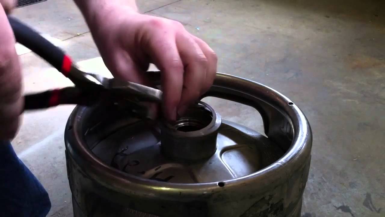

You could always open the keg and fill with water so you are not wasting beer while trouble shooting.
Here is a video on how to pull the spear out so you can fill it and the replace the spear
