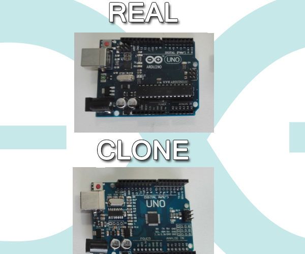

This might help you get that board going. I recieved a clone and am sol… So I have to buy one now.
I did get the cheap knock off to work on the computer and could upload the firmware to it. The issue is that the drivers aren’t there in the tablet to work with the board. A genuine uno will work and I believe the newer Leonardo boards, even knock offs, do work because those have a different USB serial adapter. I think you just have to update Serial to Serial1 in the code if you use a Leonardo. There is a forum post about that.
