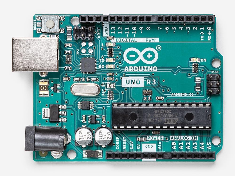

  1. Kegboard - this is your Arduino. There are plans on the site for building your own kegboard with relays, etc. but this is NOT necessary. Just buy a basic Arduino, plug it into the USB drive of your computer, download the Arduino IDE and write the firmware to it, which only takes a couple minutes.
  1. Flow sensor - This goes in-line in the beer line and plus red-5v black-ground yellow-port 2 on your Arduino. The cheapies work just fine. I’m using one from ebay that was only a couple bucks. A second sensor would go into port 3.
I have mine running on an Arduino Uno right now, so I know that works. You can buy ‘generic’ arduino boards in many different flavors that I assume would also work fine. I have ordered a generic Leonardo, a Mega, and a Nano and plan to test each of them but they haven’t come yet. I can vouch 100% that this works (although more expensive than the generics.) I can report back once I get my generics that just cost a few dollars, but they are coming from China so who knows how long they’ll take.

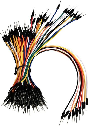

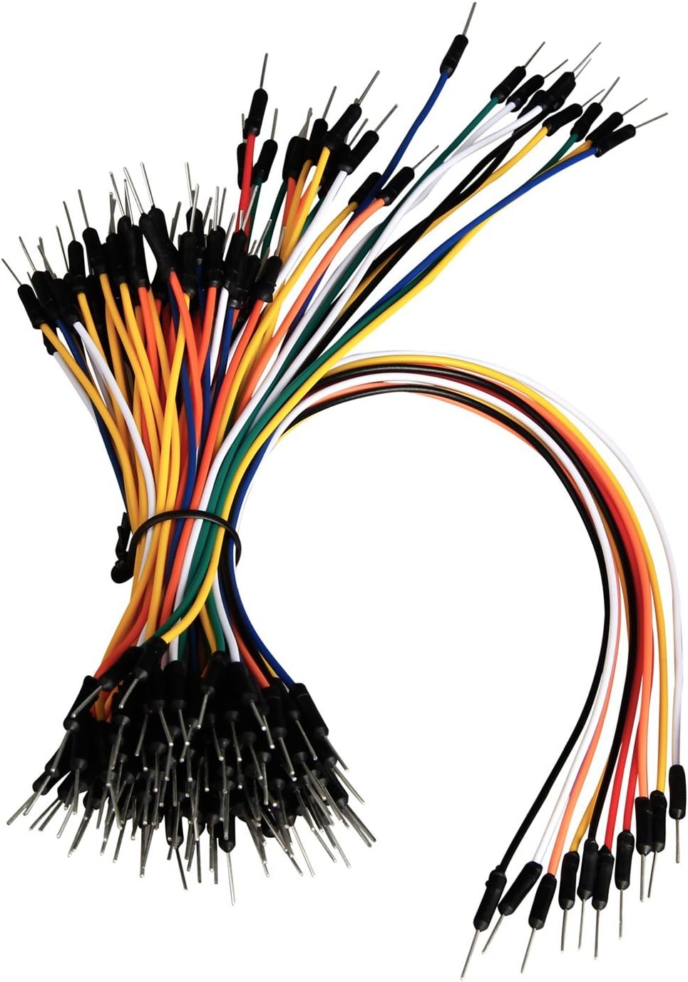

  1. You shouldn’t have to do any soldering for a basic connection if you aren’t comfortable with that. If you only want a basic setup with 1-2 flow meters, I think some basic jumper wires would do. You’d just plug them into the flow meter ends and then the corresponding spot on the Arduino. If you want them a little more secure you could get an Arduino Nano with the breakout board which would give you screw-down terminals for every port. (NOTE: I haven’t tested a Nano yet, but I assume it’d work…)

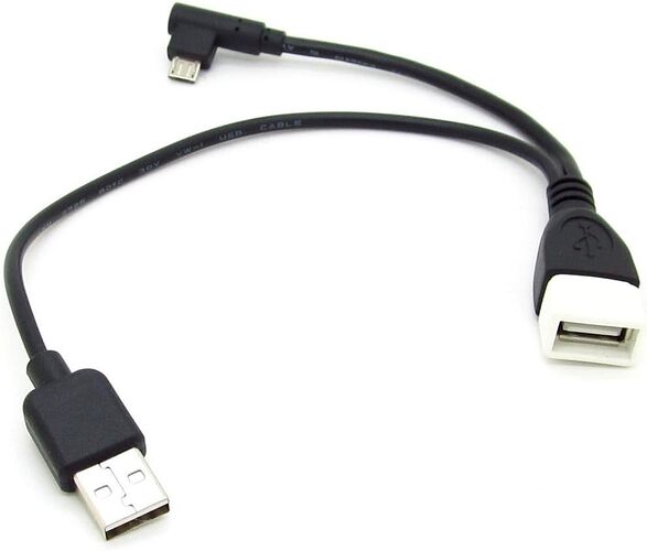

You also are going to need a USB OTG cable, which is a special adapter to plug in a regular USB device to the micro-USB/charge port on the tablet. This depends on what tablet you get. If you get the Nexus 7 like I have you’ll need a Y cable:

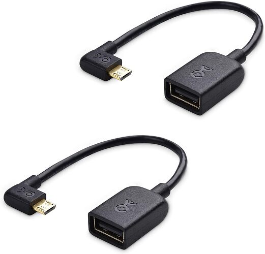

If you go with a tablet that has a separate charge port you will just need a regular OTG cable.

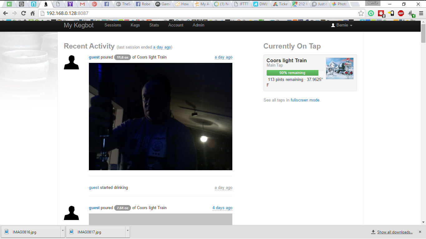

On number 4. If your set the tablet up as a server it works just like using a Pi. You just running the code on the tablet.
I can do all the below through the web server. Just doubled checked.
I didn’t see any way to add a picture of your beer when creating one - Yup have a different one per keg
I didn’t see any way to create user/drinker accounts - Yup have multiple
I didn’t see the ability to add a relay/solenoid - Confirmed setting is in web interface to add
I didn’t see a web server to log in and view stats/accounts/etc - Yup use it all the time

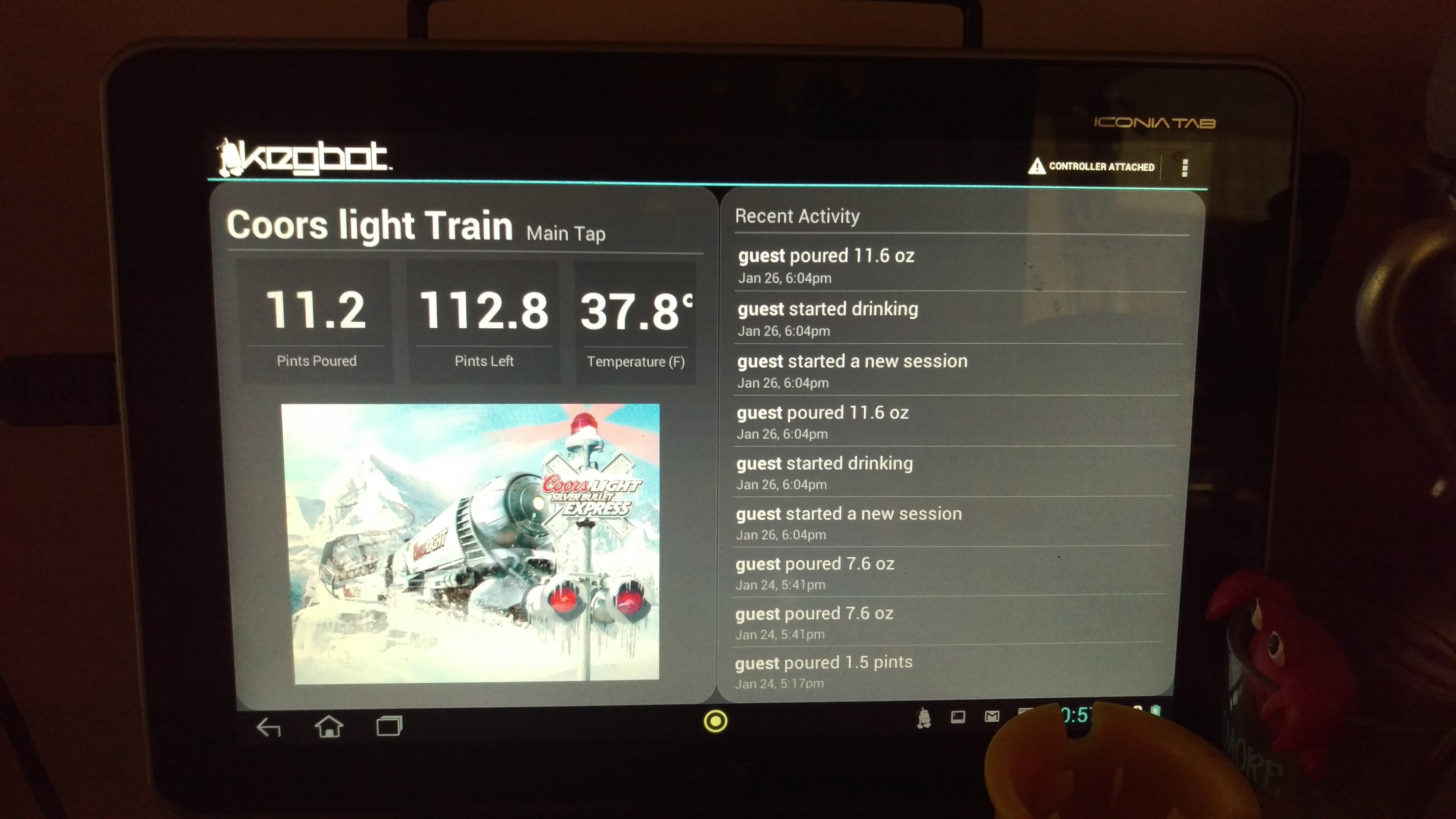

No pour session/history data on the tablet interface - This does show on the Kegbot app interface.
First pic is server running on tablet, second Kegbot app on tablet, third web interface on laptop
Thanks celblazer, good to know! So then you install server separately on the tablet apart from the kegbot app and just point it at itself. Mcguiles, looks like this is the forum thread for that.
Yup and I put the link in my first post also. It works really well, been using it since that post in July and as a hardware guy I like eliminating failure points so one less.
