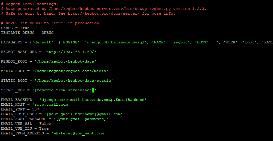

the “bad gateway” error comes after i add gmail using the old instructions
So it looks like more typo errors on my part due to copy/paste from a terminal window into the forum post.
If you copy and paste my email configuration from above, you’ll get some incorrect apostrophes around the setting values, and this makes the configuration file invalid causing the server to not start.
Check your local_settings.py file and make sure you have the correct apostrophe characters enclosing each string. I’ve also attache a picture for reference.
