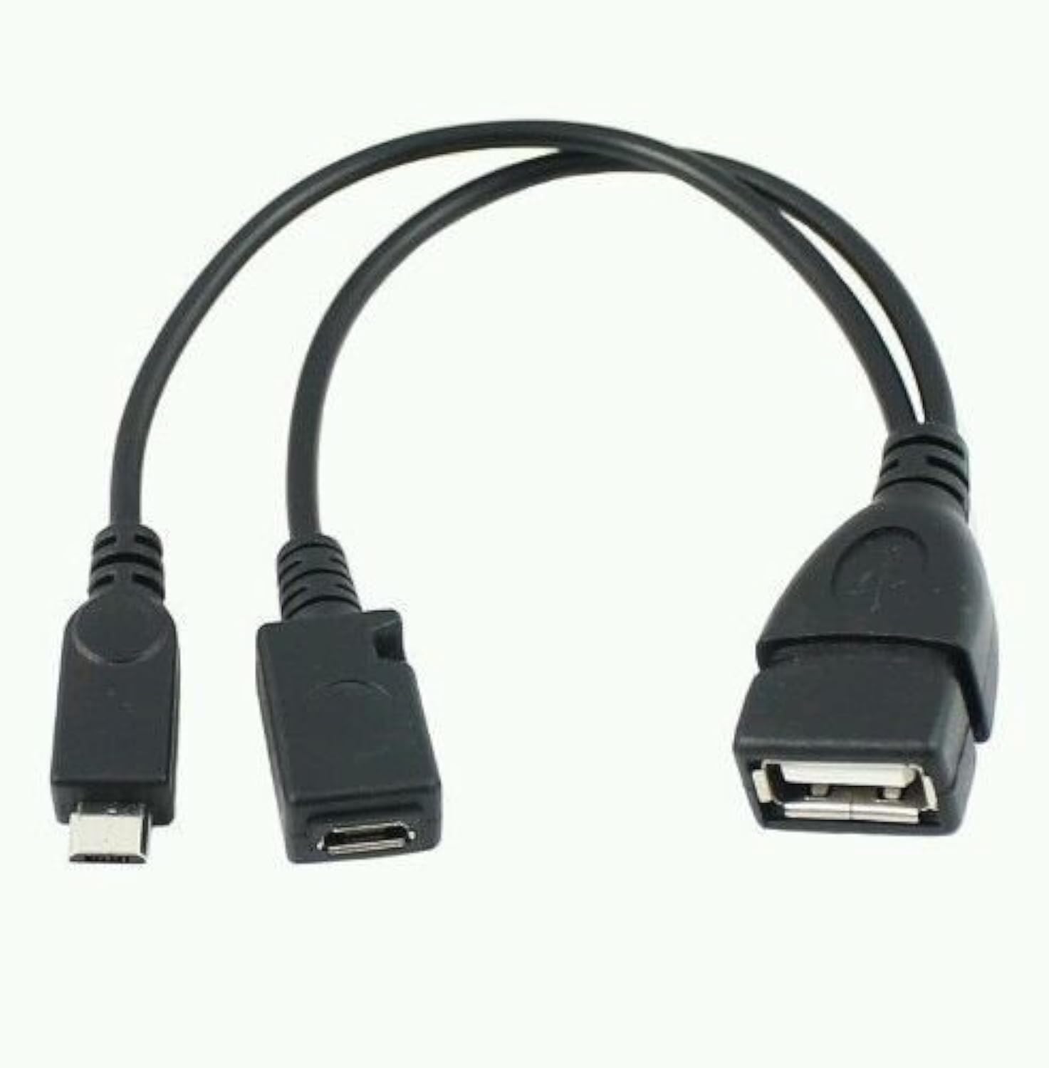

For charging the tablet and connecting the Arduino, I purchased this cable, and I just tested it. Played some Youtube videos, got the tablet down to 88%, let it charge for a bit, after ~10min its back at 90%. I had the screen on the whole time with the kegbot app open. Charges, but doesn’t actually show that it is charging, and its a bit slow.
Reading what you wrote up about flashing the Arduino, and the Kegbot app recognizing the Arduino when connected to the tablet, I believe I have done that correctly.

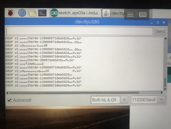

Thank you for the quick reply. I do not see any activity in the web interface under tokens or logs. I wired according to the kegboard_confog.h file. Here is what I get from the Arduino IDE serial monitor. I’m not sure if I’m doing it right but nothing seems to change when I present the token. Thanks.
Hmm, in the serial monitor you should at least see some human-readable text. I think you may want to set the BAUD to 115200. When you scan a token, you should see some activity.
That did help. I am now getting some readable data. I will see what it does with the token when I get back home. Thanks again!
