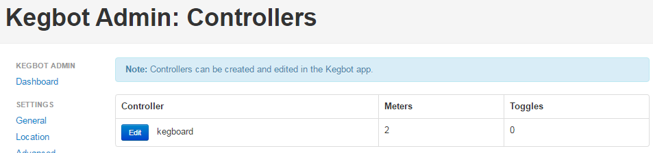

I have 5 taps in my keezer. I’ve been able to install kegberry, and 2 flow sensors on one kegboard. I purchased 3 more sensors and 2 more arduinos in order to include the remaining three taps into the system. I’m using a USB hub to connect the kegboards. It appears the kegberry thinks the two boards are the same board? I ran a test wire from pin 12 to pin 2 on both boards and it registers pours from the same tap. Anyone have any thoughts about this or know how to get the kegberry to recognize those are two separate boards?

I’m not using a tablet. Just running everything on the raspi. I tried deleting all taps and controllers. Restarted and reconnected everything. Still only shows one controller on the admin screen. I can’t add a controller on the admin page either - it says to do it on the app, but I’m not running an app. It just automatically detected the controller when I hooked it up, but it doesn’t want to show a second controller. Anyone with any ideas?
You can manually add a controller using the database admin page.
